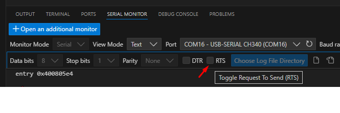

to me unchecking RTS did the trick. Was working on arduino IDE and not platformio
That is not PlatformIO`s built-in serial monitor. That is an extra VS Code extension called “Serial Monitor”!
