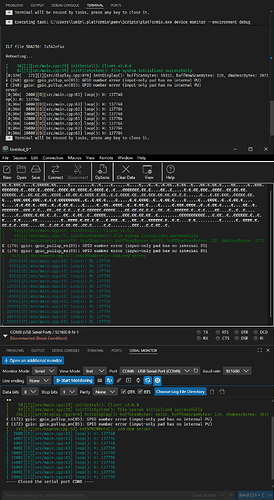

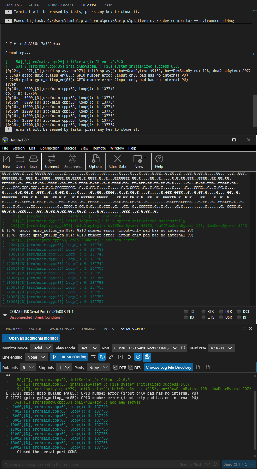

Platformio serial monitor output error. I thought it was the FTDI or cable connection. But after changing FTDI, cable and USB port, the problem persists. Then I tried using another serial monitor, it works fine.
  • Top: Platformio Serial Monitor
  • Middle: CoolTerm (standalone exe)
  • Bottom: Microsoft Serial Monitor (vscode extension)
I can’t see an error here.
If it is about the Ansii Color coding you need to set monitor_filters = direct in your platformio.ini
I already set it to direct. As you can see, the first 2 lines output color correctly. This is my filter settings:
monitor_filters =
direct
send_on_enter
esp32_exception_decoder
Looks like many packets lost. Like this line:
[ 303][I][src/espnow.cpp:53] onESPNOWRecv(): add new server
in platformio serial monitor only show:
erver
Anyone knows why Platformio serial monitor can’t read properly, while other serial monitor can?

Serial monitor did output line -- Terminal on COM3 … etc. It just that in the screenshot, I reset the ESP and the lines are scrolled out.
