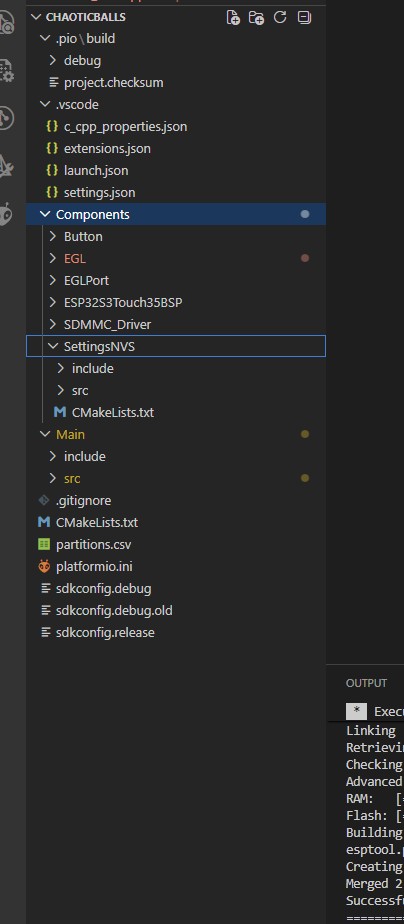

My project layouts typically look like this:
and the platformio.ini file something like this:
[platformio]
core_dir = D:\PlatformIO
default_envs = release
include_dir = Main/include
src_dir =  Main/src
[env]
board = esp32s3box
board_build.f_flash = 80000000L
board_build.flash_mode = qio
board_upload.flash_size = 16MB
board_build.partitions = partitions.csv
framework = espidf
upload_speed = 921600
lib_ldf_mode = deep
board_build.arduino.memory_type = qio_opi
board_build.psram_type = opi
upload_port = COM6
monitor_port = COM6
	-std=gnu++17
	-DBOARD_HAS_PSRAM
	-DWAVESHARE_LCD_3_5INCH
	-DLV_CONF_INCLUDE_SIMPLE
	-Iinclude
	-mfix-esp32-psram-cache-issue
[env:release]
build_type = release
[env:debug]
build_type = debug
debug_load_mode = modified
debug_init_break = tbreak app_main
debug_tool = esp-builtin
debug_build_flags = -O0 -g -ggdb
