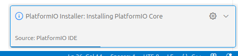

After the install and restart of VSCode I’m receiving a message window saying
This is now running for about 30 minutes w/o any progress.
What can I do to resolve the problem?

If you haven’t made any custom modifications to your ~/.platformio folder (and know if you need to have any special / older versions of platforms), I’d suggest the easiest way is to rm -rf ~/.platformio and cleanly reinstall the core.
This behaviour is often when Python is not found. Probably the reinstall installed a newer version which has a different path. Before deleting the whole folder you can try to delete the pyenv folder in folder .platformio/packages
