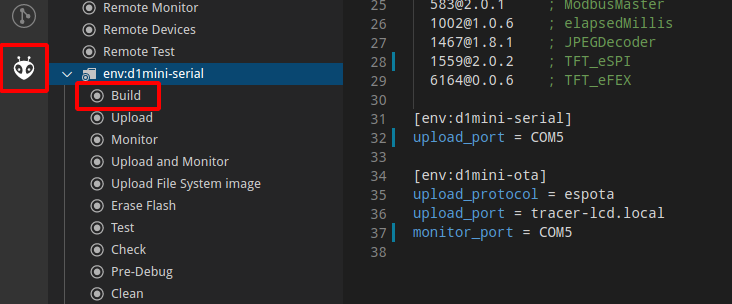

Via the PlatformIO menu
Via the command line as @msquirogac suggested.
Or you can set the default environment in your platformio.ini, which will instruct PlatformIO to only build the listed environments unless otherwise explicitly selected.
