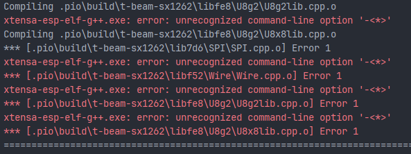

There seems to be something in Platformio that doesn’t recognize what to do with -<*>. But the build will proceed if I take that out, so i’m not sure if it would have done anything.

The thing I’m don’t get is how this is actually different from what we’re already doing. We were already using the symlink thing, and after that, the only other thing was the build_src_filter, which doesn’t seem to really be necessary. I need to know how much of this is about style and how much of it is actually required.
No. Don’t include the build_src_filter in the build_flags. The build_flags are passed onto the compiler (GCC/G++) on the command line, the build_src_filter controls which source files are suppoes to be built. Just delete line 39 and see docs
