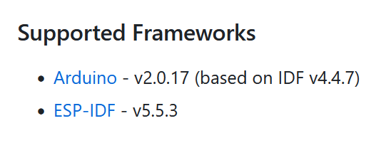

Wrong. When you chose framework = arduino, you get the ESP-IDF version that that Arduino core is built with. As the release notes say, that’s
Which perfectly matches your output.
It would be using ESP-IDF v5.5.3 if you created a framework = espidf project.
Note that you can use a more recent Arduino-ESP32 version (and thus also a higher ESP-IDF version) when you chose to work with https://github.com/pioarduino/platform-espressif32.
