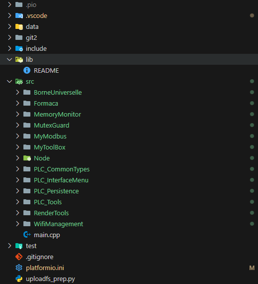

Remove the line
build_src_filter =
  -<PCF8574/test/>
and move all sub-folders from ./lib to ./src as they are no valid libraries and your project compiles without issues:

If you want to create and use real libraries, please read the documentation Creating Library — PlatformIO latest documentation
