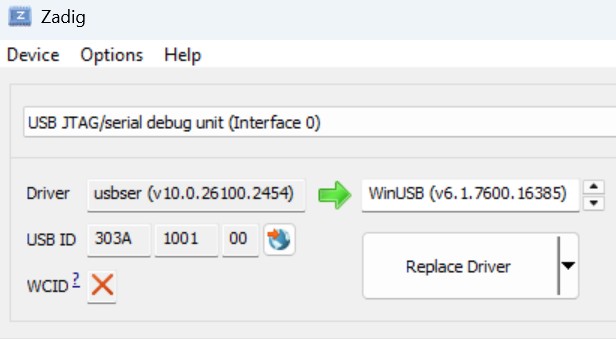

Hi all - I am trying to upload to esp32-c3 using the native usb connection. On the PC, I have WinUSB on interface 2 and regular usbser on interface 0. ESPConnect is able to connect, and can upload firmware.bin and also monitor no problem. But pio run -t upload is not working. I must be missing something on my setup. (platformio is the latest version). Any pointers would be appreciated!

Why did you mess around with WinUSB? This is not necessary at all!

I can see the serial com11 appear when I connect. I looked it up on google and it said “For ESP32-like chips, USB Serial/JTAG Interface 0 is for the standard serial console (COM port) using the USB Serial (CDC) driver (for monitoring/uploading), while Interface 2 is for the JTAG debugger (OpenOCD/GDB), requiring the WinUSB driver (for advanced debugging/flashing), with Zadig tool often used to assign these drivers correctly to separate virtual interfaces on the same chip. “
So Com11 appears and ESPConnect is able to connect through Com11 no problem. Its the platformio upload that is unable to write to it for some reason. Monitor does open it (or at least it doesn’t complain that it can’t open the port) but no logs come out. When I monitor on ESPConnect, the monitor works fine as well.
