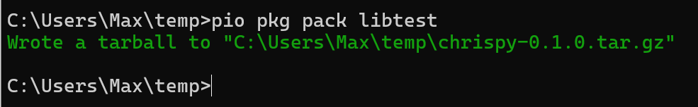

Create a new folder with just a library.json inside containing
    "name": "chrispy",
    "version": "0.1.0"
and run pio pkg pack <path to folder>.
I just get
The issue was sitting between the chair and computer. Basically, there was just a symlink I didn’t realize in one of my test programs which I’m guessing was causing the packing tool to infinitely loop. @maxgerhardt thanks anyways for your help!
