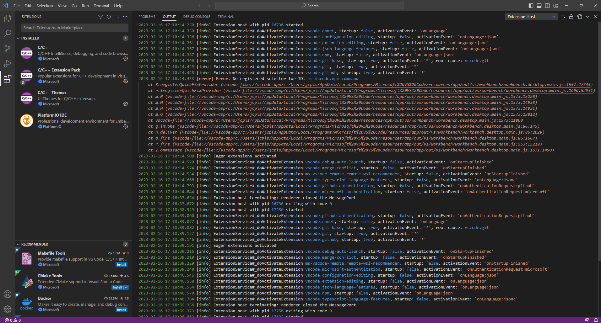

What’s the output of the Output → Extension Host tab? Does it say anything about the extensions it wants to start?
Have you tried restarting VSCode? With e.g. Ctrl+Shift+P → Reload Window.
Download page: Download Visual Studio Code - Mac, Linux, Windows
“Electron sanbox is enabled” message. i looked after and aparentelly is something of vs code. i reinstalled the program today so must be arround that. No, i didn’t do anything in particular to make it appear enabled.
Reload window. Yes. I’ve tried that and had no luck. every time i changed a configuration i reloaded the window.
images of output> extension host.
second image. i only can post one at a time…

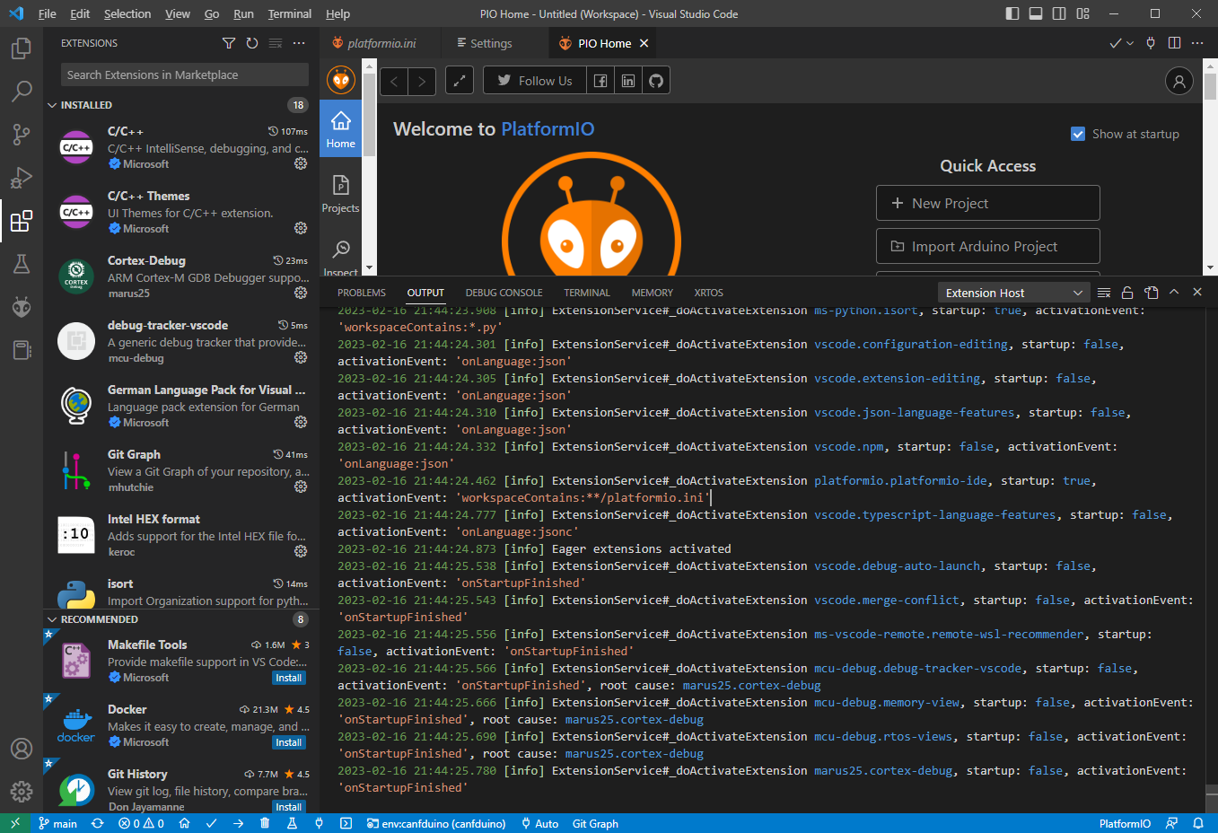

In case anyone finds this. in the newest version at this time (3.3+) after installing the extension, their logo shows on the far left. If you click that little alien, you get the rest of the install and the home button shows up.
