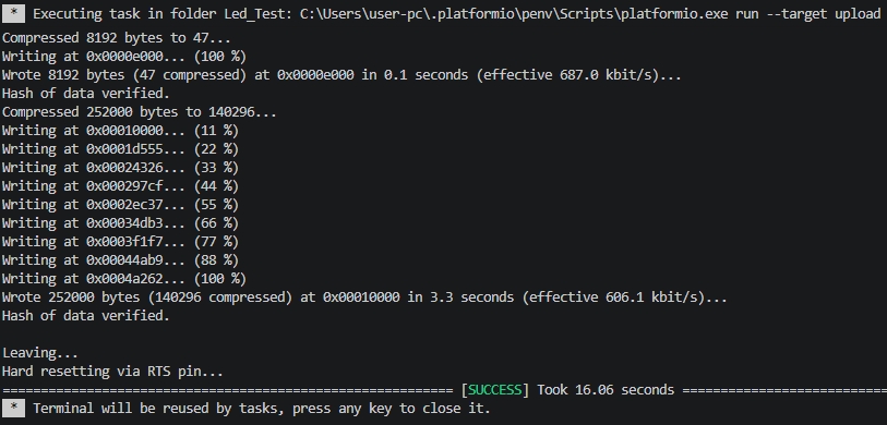

On Pio the program compiles successful, programs up to 100% but it seems the programming had not been completed as the micro does nothing. I tried everything for days…

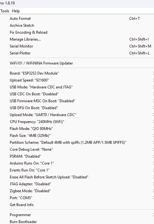

Can you show a screenshot of the Arduino IDE → Tools menu? It’s important to match all those options to the PlatformIO build.

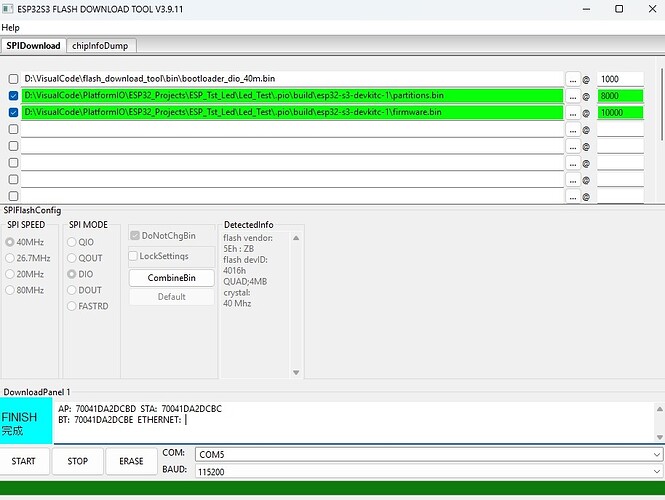

Flashing the micro with ESP32S Flash download tool: Programs the micro but it also does not run.
The board definition is fine except for the fact that it specifies a 8 mbyte flash instead of a 4 mbyte one. You might want to try
[env:esp32-s3-devkitc-1]
board = esp32-s3-devkitc-1
board_upload.flash_size = 4MB
board_build.partitions = default.csv
