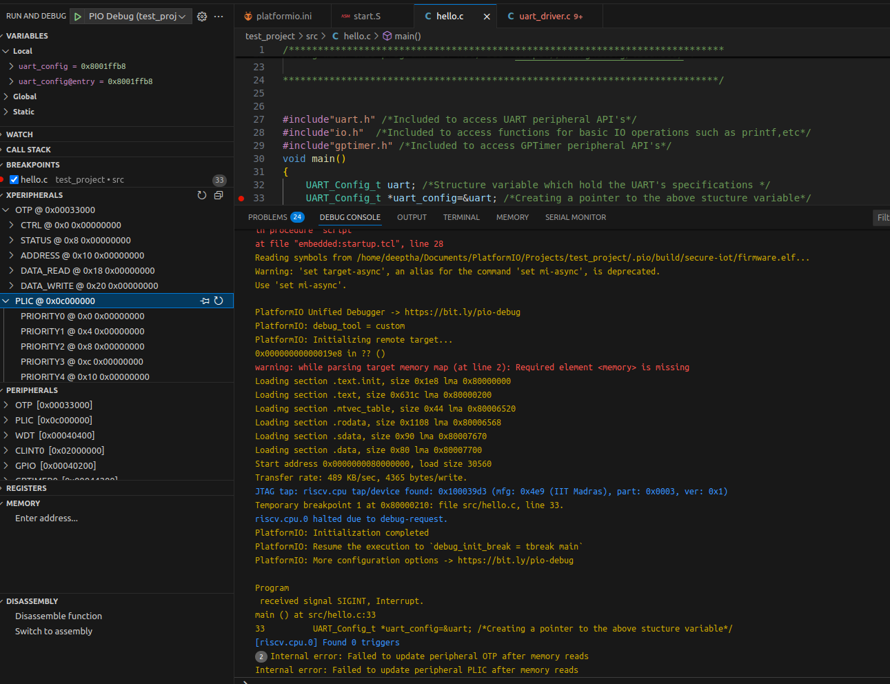

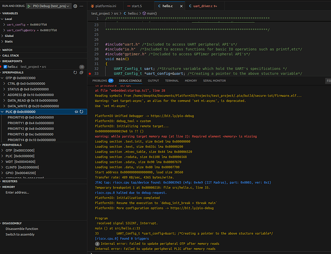

In the PlatformIO debug console, I see:
Internal error: Failed to update peripheral UART0 after memory reads
Whenever I try to step in or step out of the code in VS Code, OpenOCD fails with the same error.

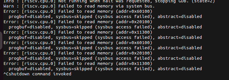

In the OpenOCD log, I see:
Error: [riscv.cpu.0] Failed to read memory (addr=0x11300)
 progbuf=disabled, sysbus=skipped (sysbus access failed), abstract=disabled

From OpenOCD:
Warn : [riscv.cpu.0] Failed to read memory via system bus.
Error: [riscv.cpu.0] Failed to read memory (addr=0x60100)
Error: [riscv.cpu.0] Failed to read memory (addr=0x20100)
(repeats for multiple addresses)
From PlatformIO:
PlatformIO: Initialization completed
Internal error: Failed to update peripheral OTP after memory reads
PlatformIO: Resume the execution to `debug_init_break = tbreak main`
