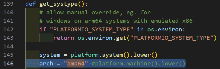

I faced the same error and workarounded by modifying PlatformIO util.py file.
.platformio\penv\Lib\site-packages\platformio\util.py
in get_systype() function,
arch = “amd64” #platform.machine().lower()
#(Override windows_arm64 by windows_amd64)
Windows 11 on ARM has emulation layer of amd64 binary so this worked fine on my project.
