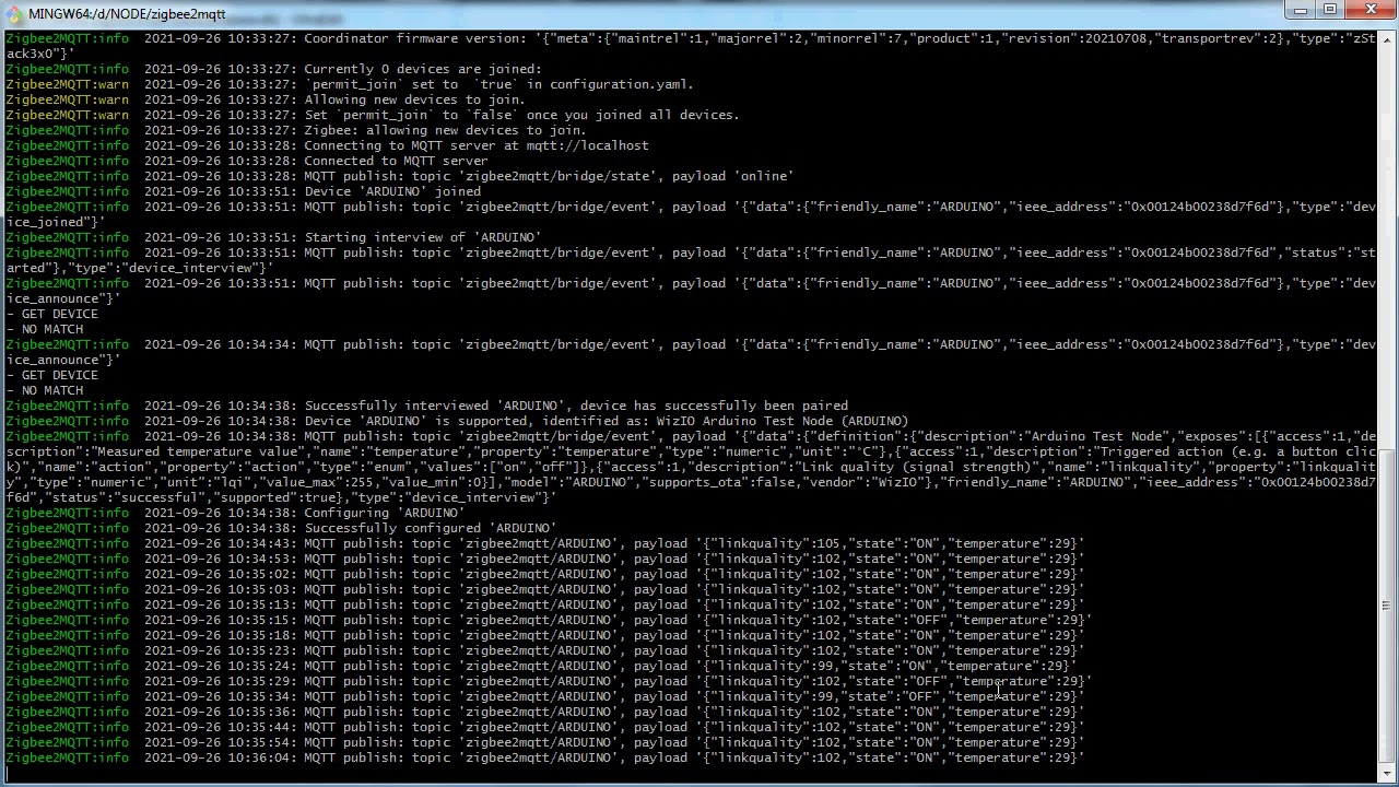

Arduino / Zigbee - there is not free solutions … stack is “hard”, but: Nothing is impossible…
