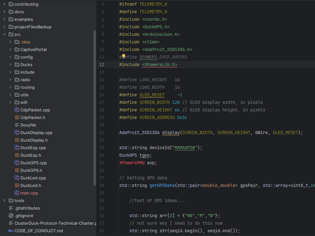

I have a project that compiles and flashes for another dev but i’m unable to do the same when a certain lib is included. Even though it is in the platformio.ini build file and is properly downloaded as a dependency, the build fails thinking it can’t find the header file that is clearly included. The relevant portion is in the screenshot.
The interesting thing is that it has at various times failed to pick up other included libraries, but they are being found now for some reason. I’m not sure what the root of the problem is, but this is the platformio.ini entry:

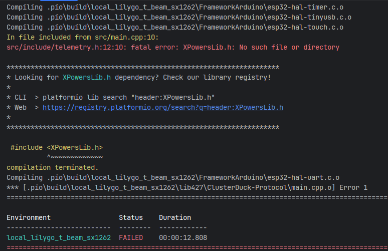

What’s the output of pio run -e local_lilygo_t_beam_sx1262?
I only use the command line and this is the command: pio run -t upload -t monitor -e local_lilygo_t_beam_sx1262 --upload-port COM4
This is the output

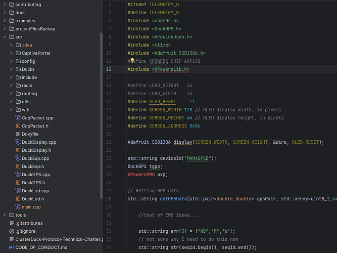

CLion’s syntax highlighting agrees that the header file is present today, so the class now shows in the proper colors. Platformio is also now building XPowersLib into a static lib, but I’m still getting this error.
