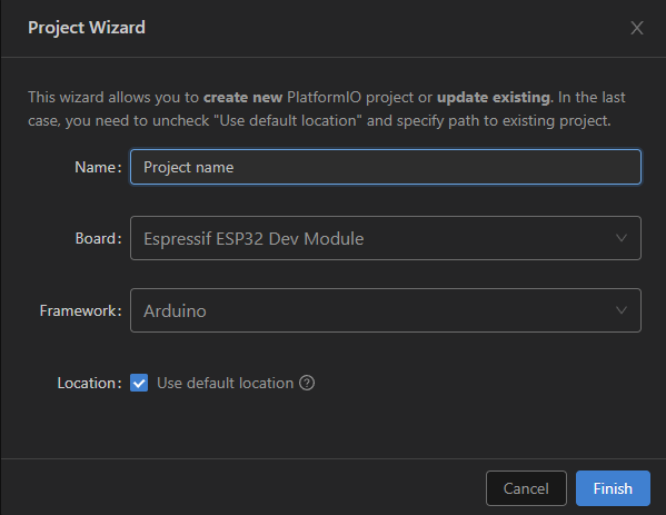

I am getting started with VSCode and PlatformIO for ESP32 and developing on Linux. My computer does see the dev board. I installed VSCode, C++ extensions and the PlatformIO extension. I created a new project but the only framework listed was espidf. I was expecting Arduino. I selected a board that I think is correct but the name is not a perfect match. My board is ESP32-DEVKITC-VIE. I selected esp32-c6-devkitc-1. When I actually created the project (it did take several minutes) the src directory has a main.c which has void app_main() {}, but nothing more. Examples that I have been trying to follow have a few stubbed functions in the initial source file.

You have selected the wrong board! Choose “Espressif ESP32 Dev Module” and Framework “Arduino” in the project wizard.
Or edit the platformio.ini manually:
Thank you for the help! At first I made the changes to the platformio.ini file. When I saved it did a lot of work, but didn’t regenerate the project. I created a new project and everything is as expected.
  1. How could I have forced a project re-gen after changing the platformio.ini?
  2. How should I have known to use the Espressif ESP32 Dev Module board?
This is usally done automatically when you save the changes in the platformio.ini.
ESP32-C6 is a different MCU than ESP32.
See Espressif 32 — PlatformIO latest documentation and ESP SoCs | Espressif Systems
