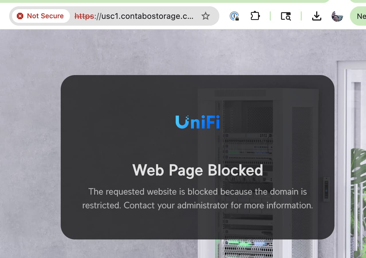

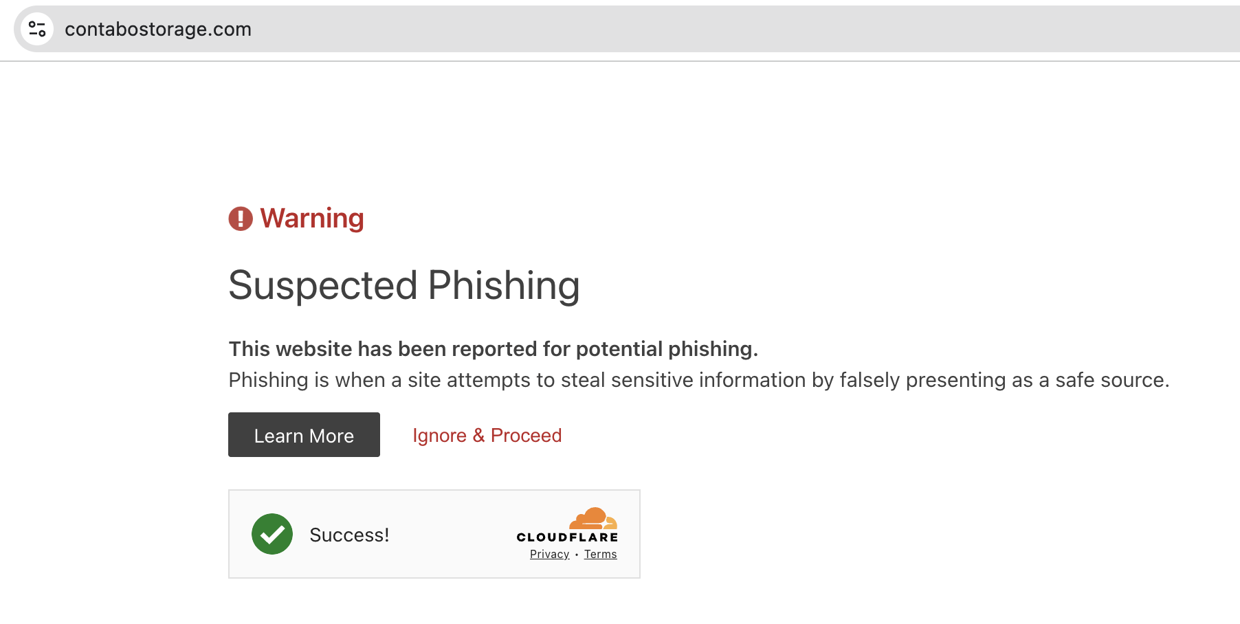

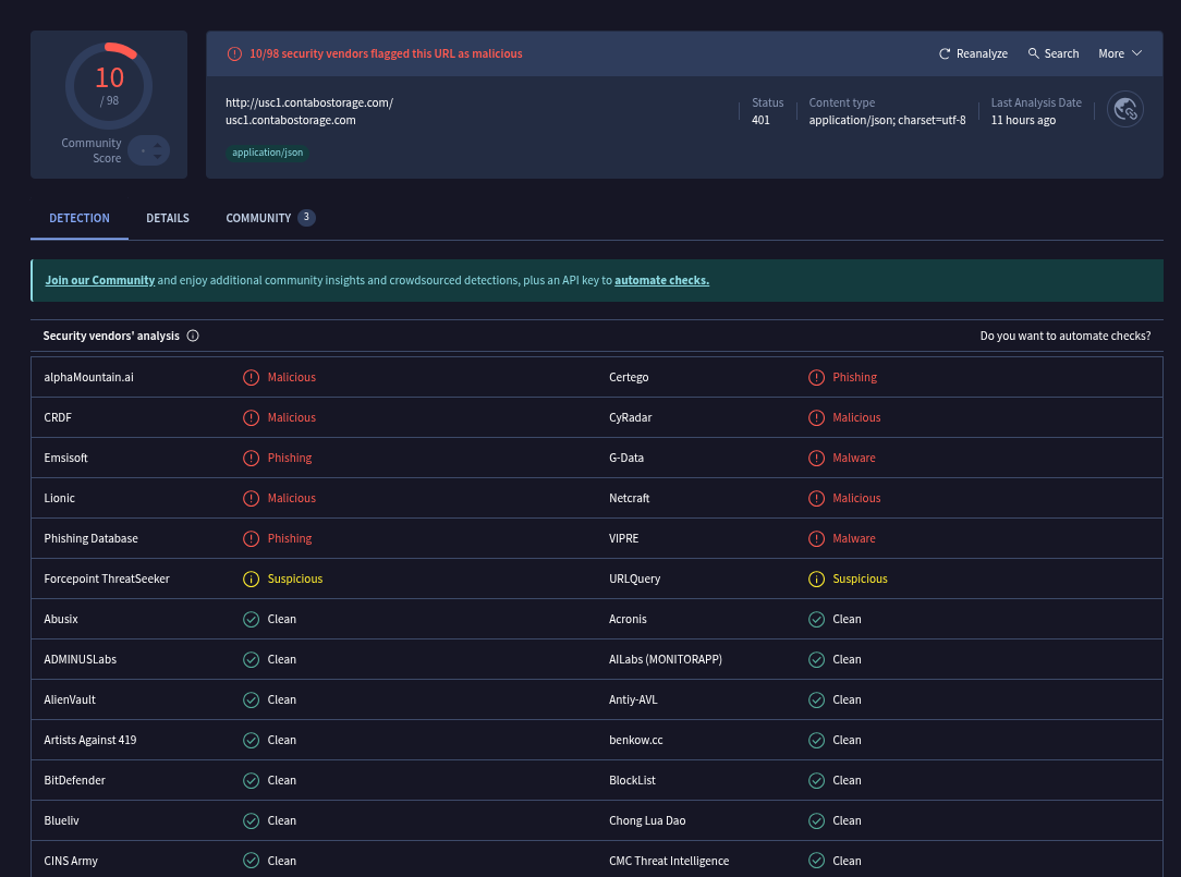

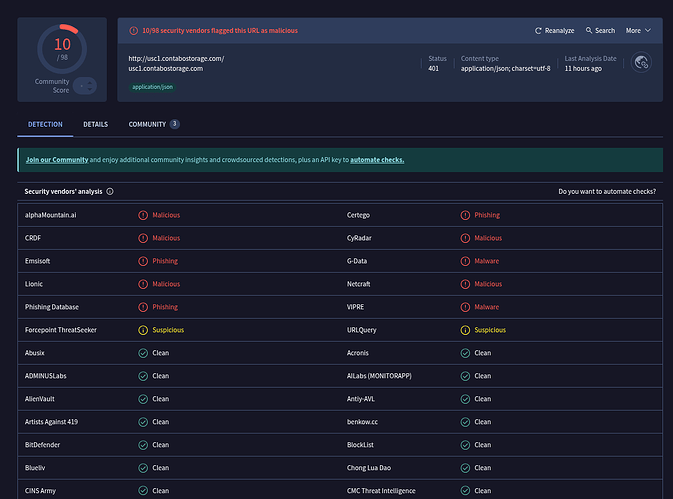

It seems the site is blocked by a number of malware defenders
Is there a way to manually download and install what is required, or update the CDN list?
Looks like I may have found the answer. Edit my plaformio.ini and change the platform to use the github url.
; platform = espressif32
The Ubiquiti UDM content filter and also Cloudflare both don’t like usc1.contabostorage.com maybe it should be removed from the mirrors.
