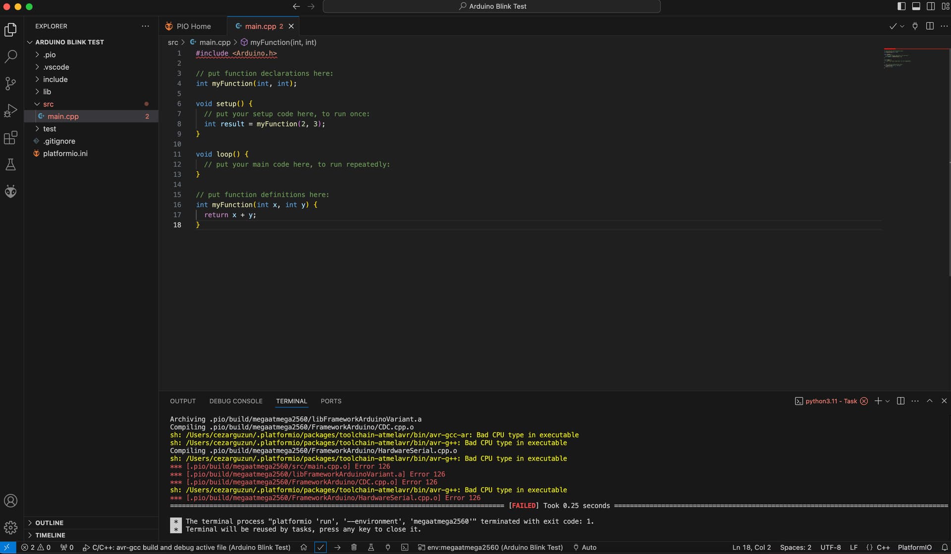

Just installed PlatformIO and created a new project,I am trying to compile my original src code however I am getting a “Failed Status”.
Please let me know what should I do.

![Screenshot 2025-02-24 at 18.44.32|690x402](upload://jzoRaI2daeApHBRCRqrJuS88ewY.jpeg)

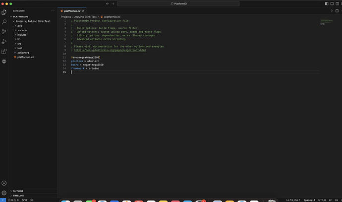

Dear Sivar,
[env:megaatmega2560]
platform = atmelavr
board = megaatmega2560
Please see attached the content below:
