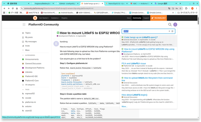

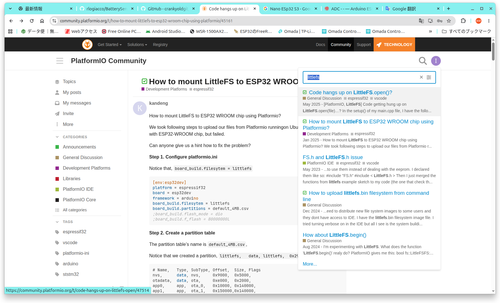

You might also find some helpful hints by looking at topics previously discussed in this community (see the attached image).

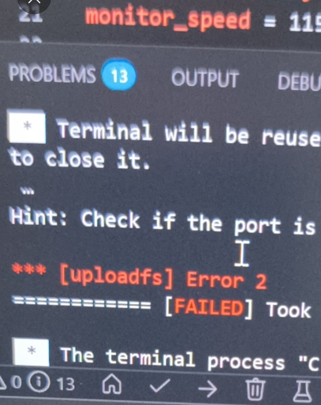

I’m sorry but I have a similar problem, I don’t want to take so much time but my time is definitely running out, I connected another identical board and tried to upload it with the updated settings I had previously entered, the upload was successful but the data file upload still ends with the same errors 1 and 2, I added button support and unfortunately I still can’t upload the data file.
This problem doesn’t seem to occur in the A00005 nano board, but I configure it a bit differently.

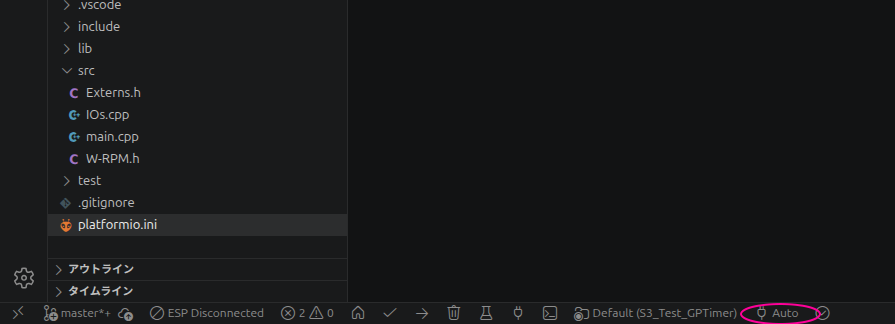

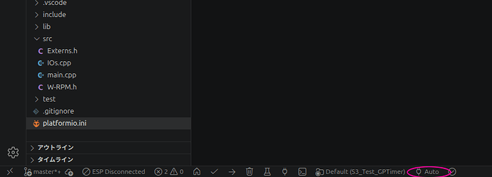

Also, please take a look at the very bottom of the PlatformIO project screen in VS Code (I have attached a screenshot for reference).
If you click the icon circled in the screenshot (which displays a plug symbol and “Auto”), a list of available ports will appear; this allows you to verify that the port changes when you switch boards.
If this icon is set to “Auto,” PlatformIO will automatically select the port if you haven’t specified one in platformio.ini.
This is easy to do, so it is likely worth trying out.

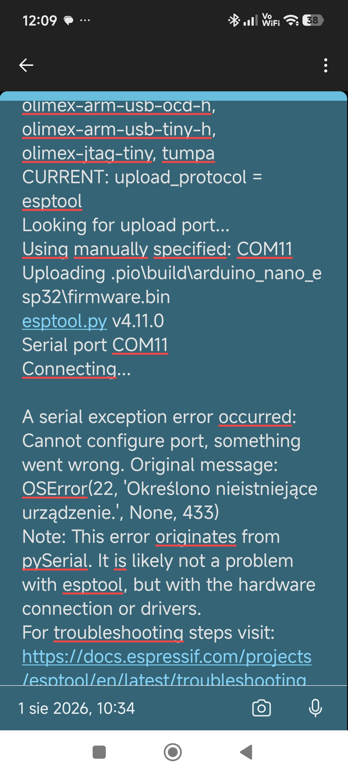

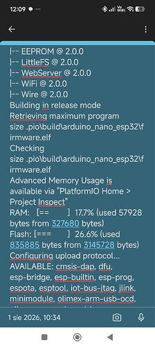

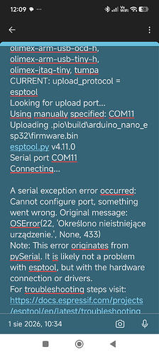

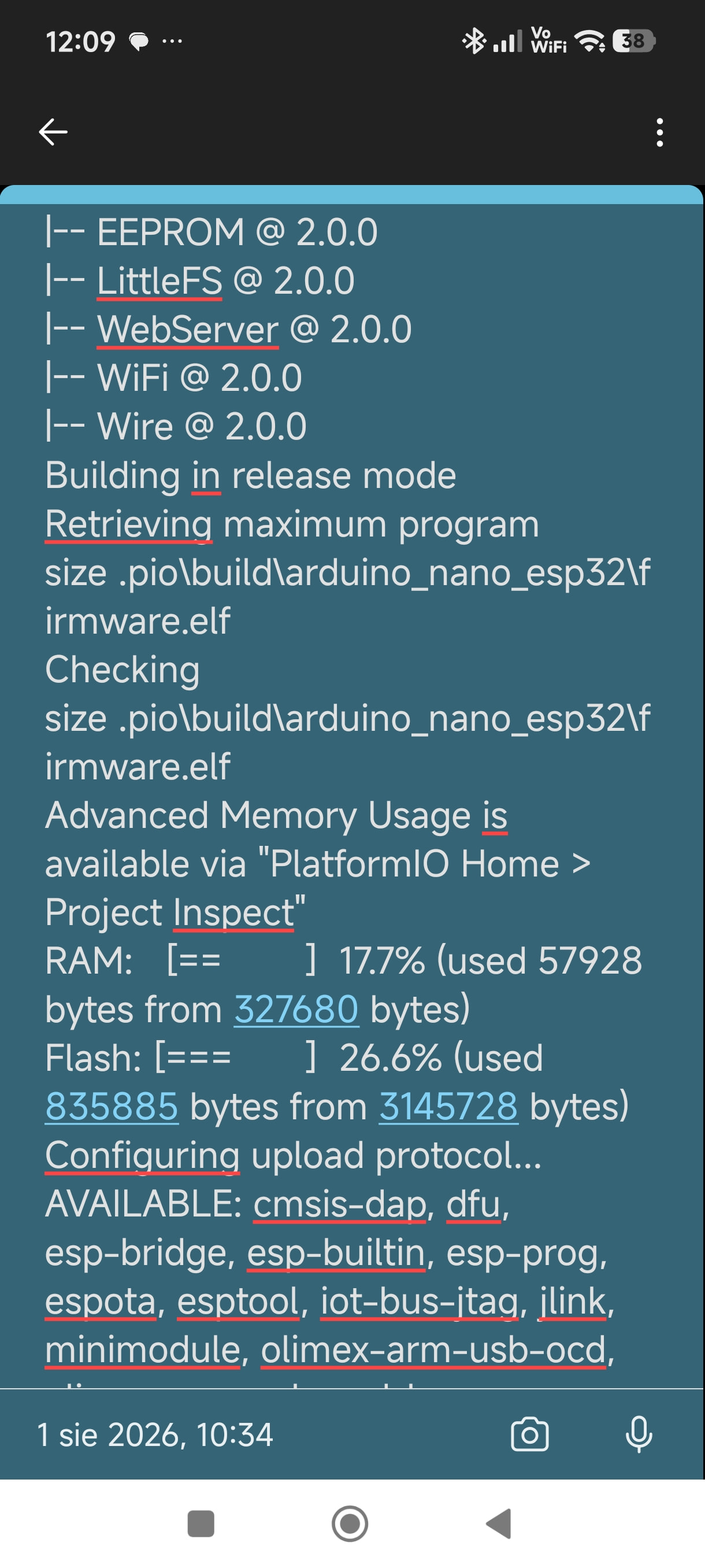

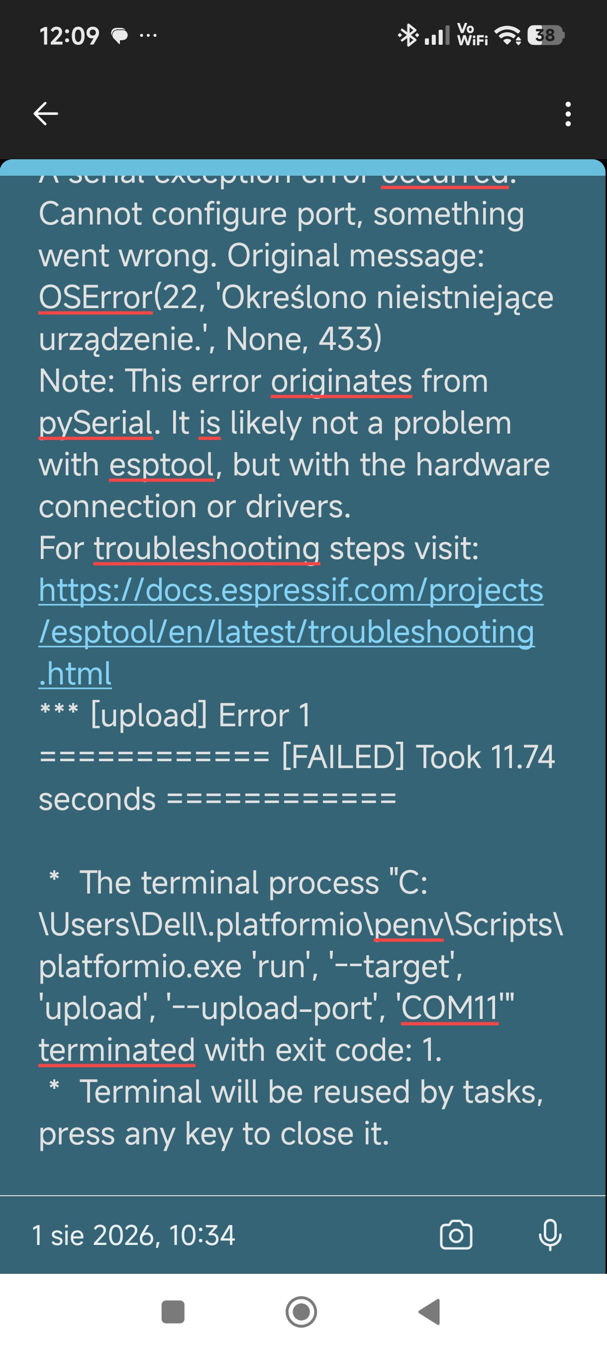

Thank you, the only problem is that the content of the upload process contains links, hence the error message when sending information from the upload process about the error
The log showed ”Cannot configure port” when connecting to COM11.
This means “Not found COM11”.
Try “Auto”.
It’s the same message all the time, but in the preview I can see the connection of the com11 port and in the device manager, also during the board reset, the port disconnects and reconnects, and at the end of the upload process, sometimes it seems to disconnect from the port and so on.

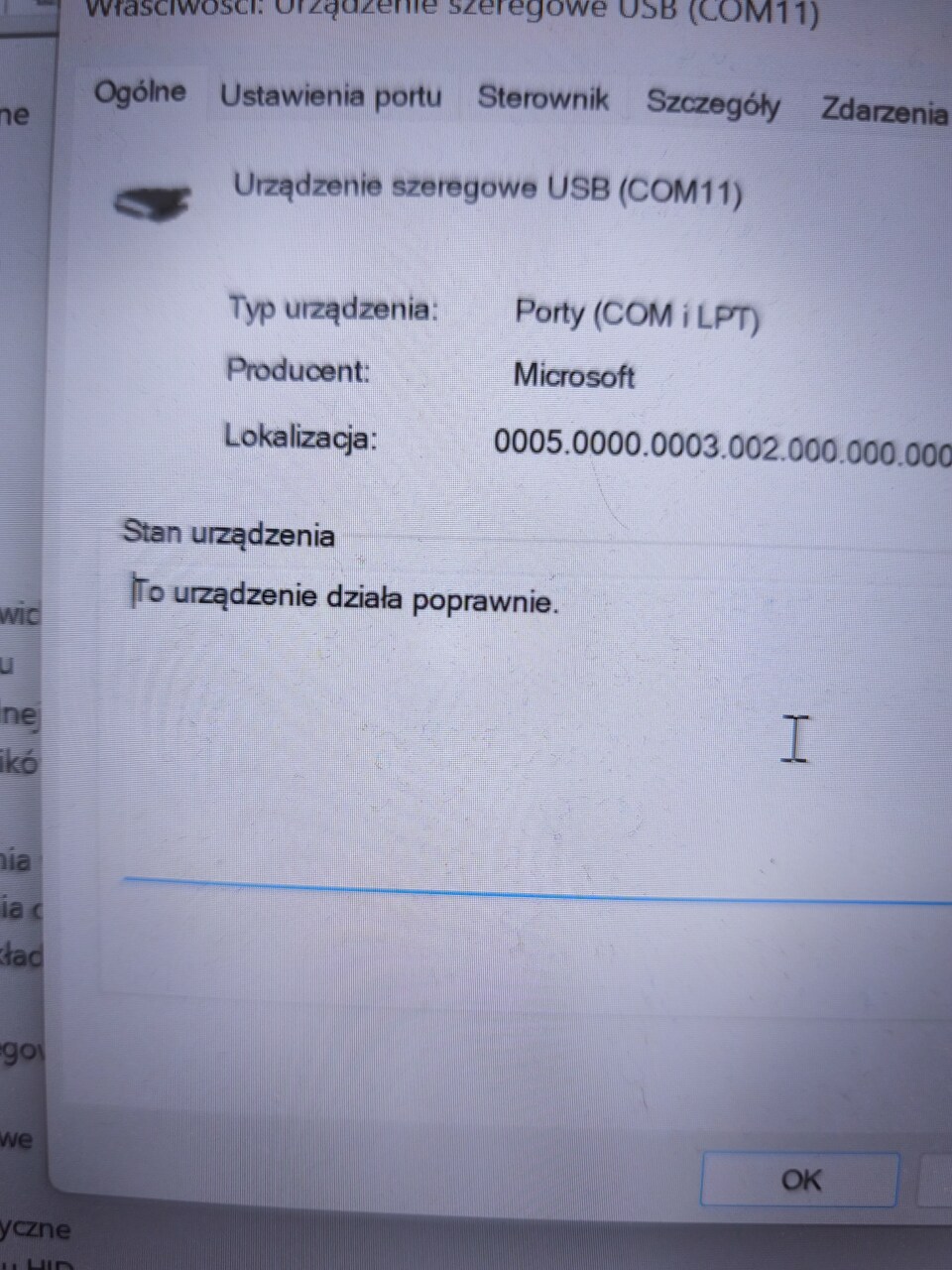

According to Arduino documentation, the NanoESP32’s USB port is the ESP32-S3’s native USB port; consequently, the connection is temporarily lost whenever the device’s reset button is pressed or it restarts.
I am not sure if this applies to your situation, but it is common for issues to arise from details that differ slightly from one’s assumptions—often in areas overlooked because one assumes, “There is no way I could get such a basic thing wrong.” Just to be safe, could you check the following points? (I am not questioning your competence; I just want to rule out the basics.)
  1. Does the Windows virtual COM port assign the same port number (COM11) when you connect different NanoESP32 boards?
    When I connected four of my own ESP32-S3 N16R8 boards to Windows via the native USB port, each one was assigned a different virtual COM port.
    In your case, it seems that different boards are being assigned the same COM11 port; is that correct?
  2. Do you have multiple devices of the same type (NanoESP32) connected to the PC simultaneously?
    If so, please try disconnecting them.
    Does the issue persist?
  3. Does the situation remain the same if you swap the USB cable?
    I have seen cases in this community where the problem turned out to be a hardware issue, such as a faulty cable or a damaged chip.
