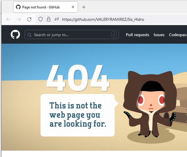

Yes, the project is here.
Basically I’m doing a refactoring of the code to start making it modular but that is the only functions that bothers me roght now
now is public, you can access it

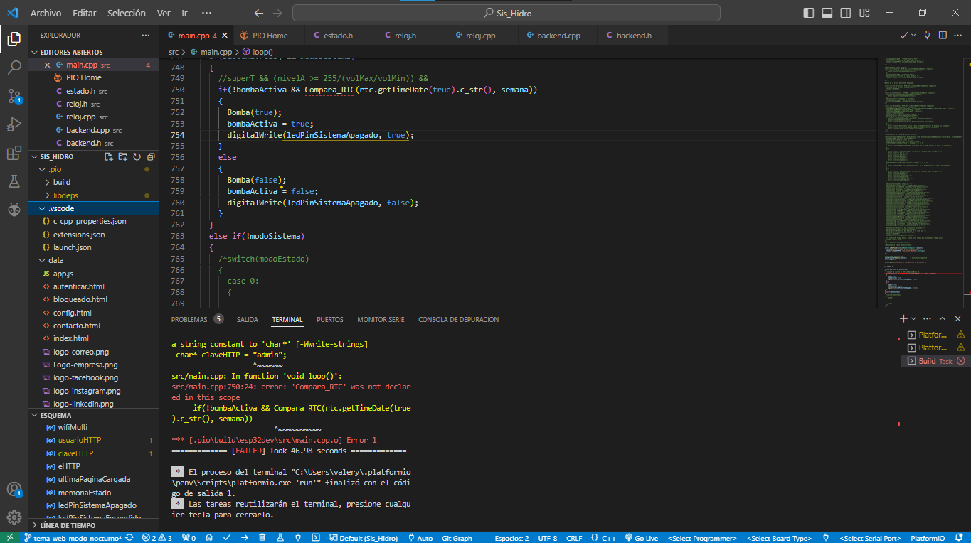

then is my installation of platformio what is doing bad things, I think is the linker, so, what can you advice to do to solve the problem
here is the error
like I said, I installed vscode and platformio from zero several times
