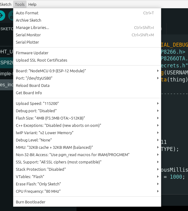

Please show a screenshot of your ArduinoIDE settings.
