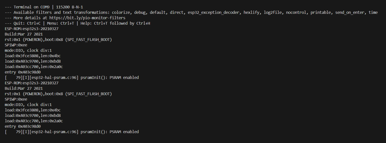

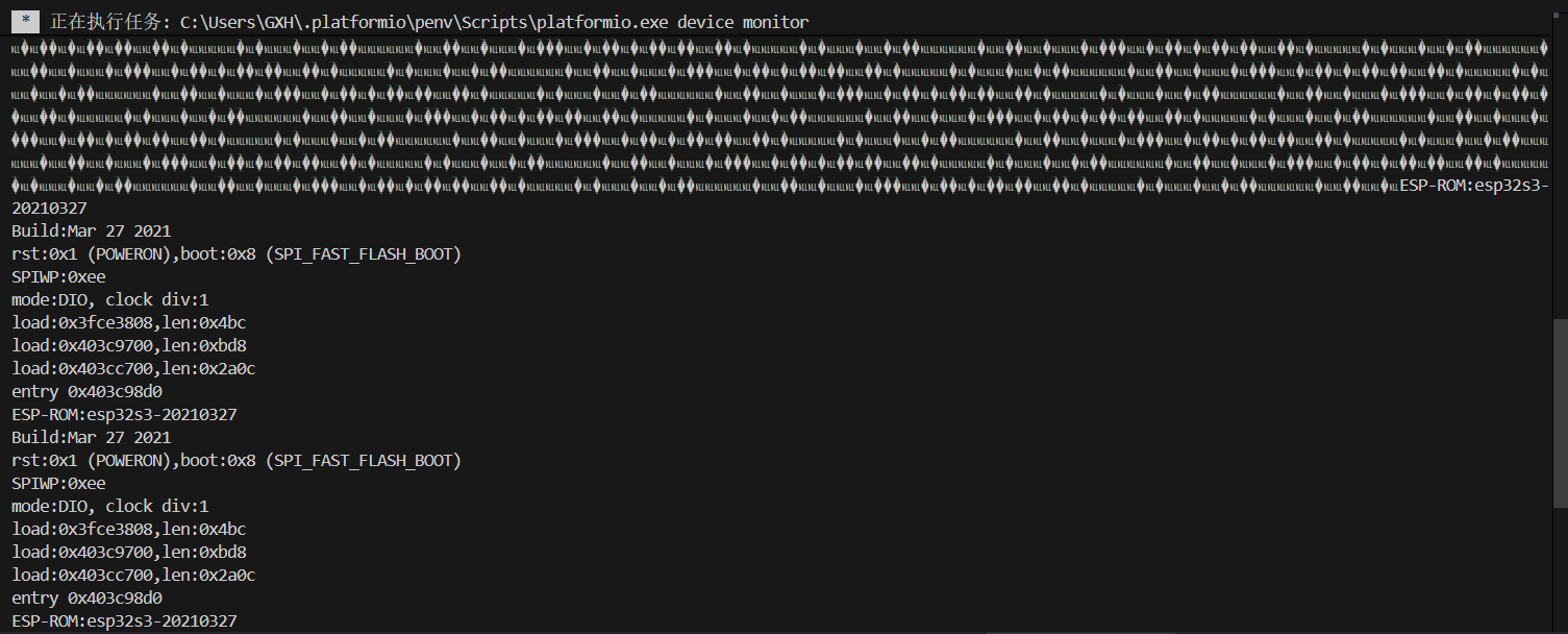

My board is esp32-s3-n16r8. After configuring and burning according to the official JSON, the serial port information always crashes
The content of this serial monitor will still be like this even if you press the reset button.

This is the bootlog and will be always printed after reset / startup. This is fine and no errer.
Does this message repeat over and over again?
Yes, this is my main.cpp. It keeps restarting repeatedly and doesn’t execute the program. I’m a beginner and don’t understand much, but no matter what program I burn, it gets stuck in this repeated restart and there’s no follow-up.

I still have the same situation after switching to 13.

oh Thanks, it seems that PSRAM is enabled, but my main.cpp hasn’t changed, and it still doesn’t respond or crashes.
from where you have this ? and you log place as text no image plus load fw part too.

Yes, that’s right. I’ve tried many settings, but it’s always DIO. I can’t adjust it to QIO. It’s an ESP32-S3 N16R8 board. Do you have a solution? I really need it.
I mean DIO is normal in ROM boot stage, most compatible load partitions info and bootloader.bin then switch to configured mode and load app and run. Seems some part of this dont work. Show schematics how you connect , GPIO used etc.
