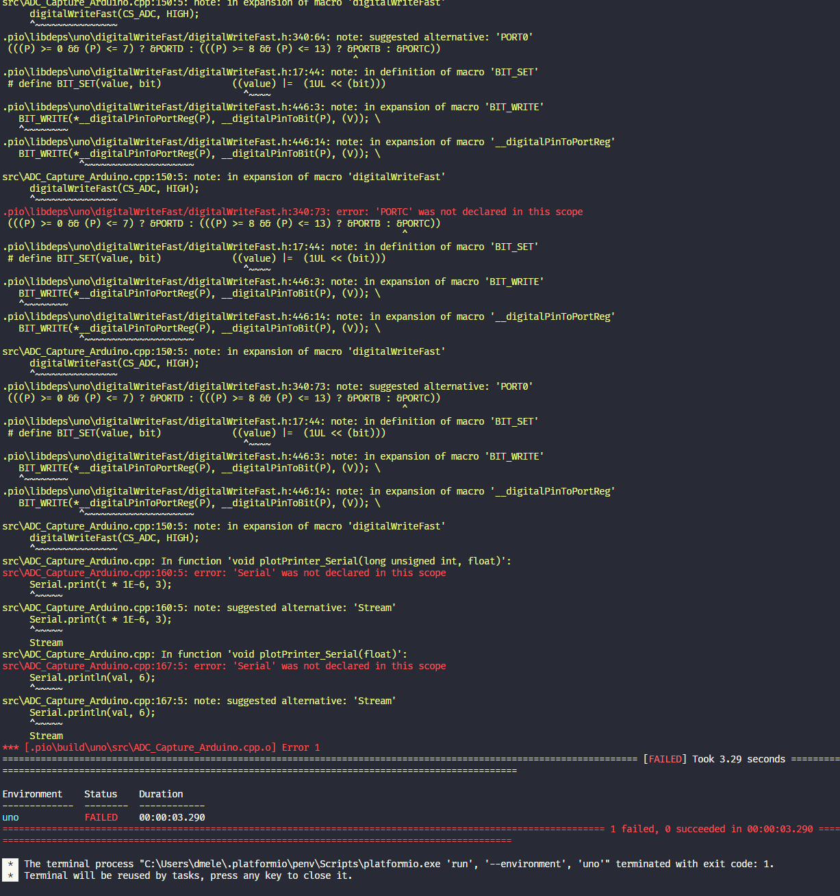

Upon building ONLY for Uno I get a TON of errors regarding the SPI library (which my project heavily depends on) and a contributed library digitalWriteFast
… the screen goes on and on with errors (I do not want to copy-paste 6 screenshots here), however, particular attention to the following one:
where even Serial is not getting recognised! What is going on?

When I looked at the source code, it was already complaining in avr/io.h that
#    warning "device type not defined"
which should not happen since it normally hits this line
#elif defined (__AVR_ATmega328P__)
#  include <avr/iom328p.h>
and __AVR_ATmega328P__ is a built-in macro that gets auto activated when avr-gcc is invoked with -mmcu=atmega328p. So the only thing I can think of is that -e destroys this because it’s some “disable built-in macros” flag for GCC.
