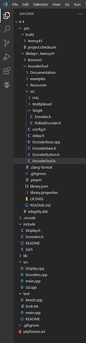

And if you move this code into a .cpp file to garuantee it only exists in one object file? (With the appropriate namepace declaration of course.
where should I move it or should I rename it to Encoder.cpp
This is where the files are:
I would create a file called Encoder.cpp and put the implementation in there, in the same namespace.
