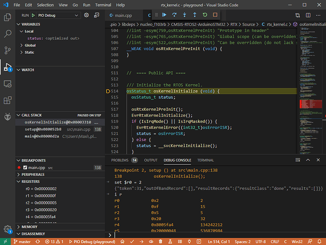

E.g. when I put a breakpoint here and R0 is 0:
I execute the set $r0 = 2, print the registers using i r (info registers) and advance one instruction using stepi (PIO’s register view doesn’t update otherwise… but the processor has internally set the requested value).
I then get the expect state
