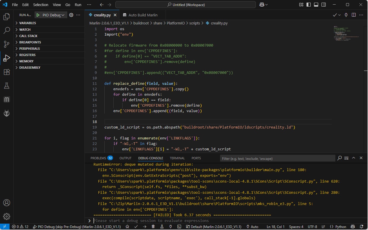

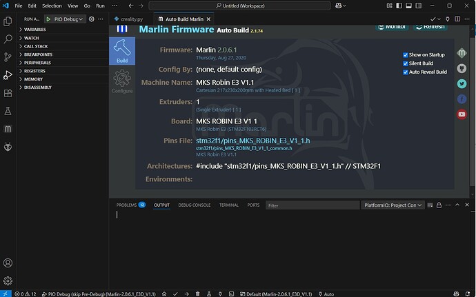

I’m trying to compile a bin file for the MKS Robin E3D v1.1.
I downloaded the Marlin file and opened it in PlatformIO and I don’t get the Build and Upload buttons.
I changed the files creality.py as suggested with the .copy() and with the change as shown in the picture and I still get the “deque” error.

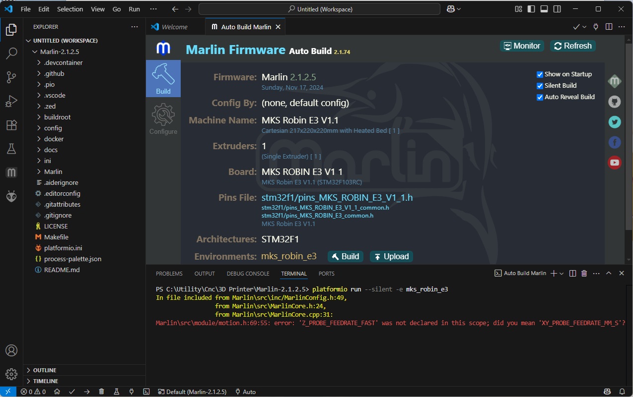

I tried to use a later Marlin but it gives me errors too which I think has something to do with the fact that newer Marlin has different terminology than the older one but there is nothing I can do about it.
Is there a solution, besides dumping the new MKS board to the garbage?
But the error trace shows that it’s coming from mks_robin_e3.py, not creality.py. You need to fix the bug there.
