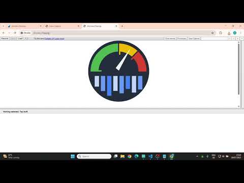

Click on the image to get to the video tutorial:

The video starts with a quick overview and then goes into the details of the different features (watch it in 1080p if you want to be able to read the code and text labels in the traces), but the quick-start guide goes as follows:
  1. Either add lib_deps = mabuware/mabutrace to your platformio.ini file if you have a framework = arduino project, or add an idf_component.yml manifest file with a dependency on mabuware/mabutrace if you have a framework = espidf project
  2. Include mabutrace.h in the implementation files containing the functions you want to profile
  3. Initialize mabutrace by calling mabutrace_init(); and mabutrace_start_server(81);
  4. Insert the TRC(); macro at the top of the most important routines of your application
  5. Compile and launch your application
  6. Go to http://(your_IP):81/ and click on “Capture Trace”
  7. Either click on “Save Trace” and then open it in “chrome://tracing” if you are using the chrome browser, or click on “Open Trace in Perfetto” otherwise
