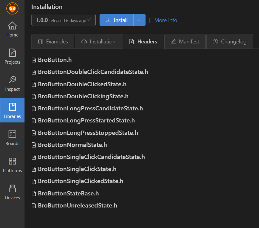

@ivankravets, Why it’s not updated in VS Code? Manifest is ok, headers in VS Code and headers here (PlatformIO Registry) are different
It’s showing 1.0.2 for me.
Probably need to restart VSCode (or at least kill PIO Home) so that it’s no working from local cache.
We cache for a few hours the same requests to API on your side. To clean cache - just go to any “Updates” tab in PIO Home. For example, PIO Home > Libraries > Updates.
