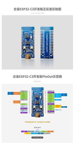

How can you use these pins? There is no GPIO12 or GPIO12 on an ESP32C3 chip or the board…
The board also has no dedicated USB-to-serial adapter, so the ESP32C3 chip handles everything. THere has to be a regular Serial.begin() to initialize USB communication. The hardware UART (“TX”, “RX” label) is then either Serial0 or Serial1.
The board I’m using is this.
Now whenever I connect the board, windows cannot recognize it. I cannot upload or open serial monitor.
