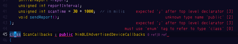

My second issue is that using emacs with CCLS and the platformio-mode plugin, as recomended by pio docs, header files seemingly are misinterpreted as being C headers, rather then C++.
Note in the above screenshot, the error message
must use 'enum' tag to refer to type 'class', indicating this is the case. I have done everything i can think of to resolve this issue, rebuilt the compile-commands.json and .ccls files, but nothing resolves it.
