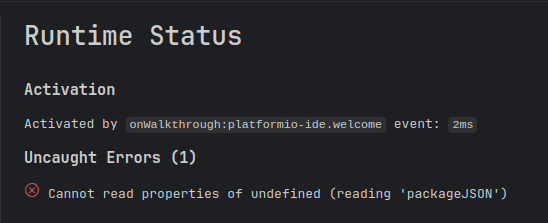

So I’m on wayland on Arch linux and whenever I try to click the little alien icon, I get a side bar that has the words “Initializing PlatformIO Core…” and it not doing anything even after a long time. Now when I tried hovering over the extension banner, I see a runtime error. Now when I tried looking at the error it was this:

Probably it does not work since the Microsoft Intellisense extension is not available. The extension is closed source. You can try pioarduino extension instead. This extension does not have the dependency to the MS extension. You can install clangd for Intelisense
