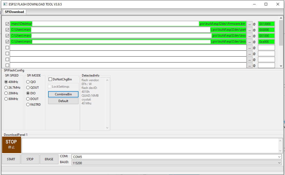

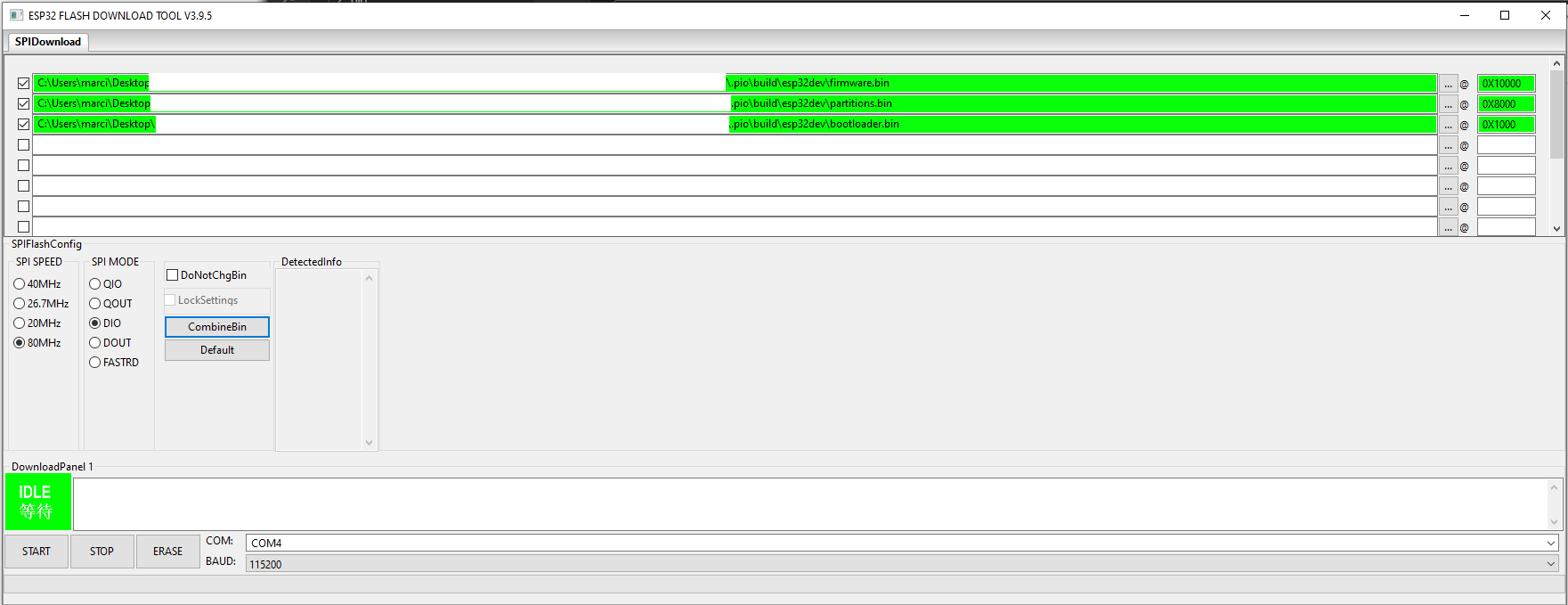

Unfortunately, I can not upload the source code - confidentiality agreement requirements and in addition, the code has more than 5000 lines in many files. Below I upload the settings from the platformio.ini file and a screenshot from the ESP Download Tool

Okay. The uppercase X in addess constants like 0X1000 seems suspicous but I’ll let it slip.

I checked what PlatformIO sends and tested the same files in ESP Download Tool, but to no avail, still UART does not work.
If all addresses and files match (and I also see it matches DIO + 40MHz), it might just be that the ESP32 needs a reset (powercycle or press of the reset button) so that it starts running the written firmware? That’s what esptool.py is doing with --after hard_reset.
