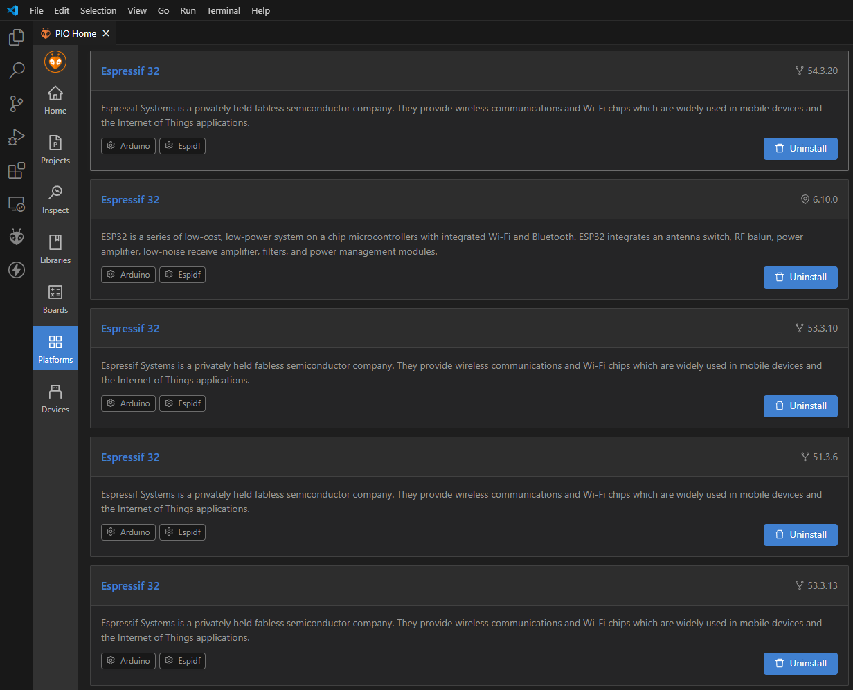

You have to check which versions are installed on your system or have a look at the output during a build.
Example for installed platforms:
Highest available version: 54.3.20 (pioarduino → Espressif Arduino 3.2.0)

Note these lines:
PLATFORM: Espressif 32 (54.3.20) > Espressif ESP32 Dev Module
- framework-arduinoespressif32 @ 3.2.0
The project is using Espressif Arduino 3.2.0.
