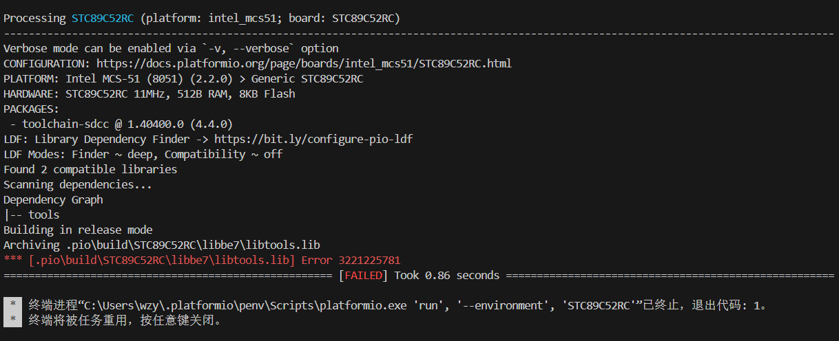

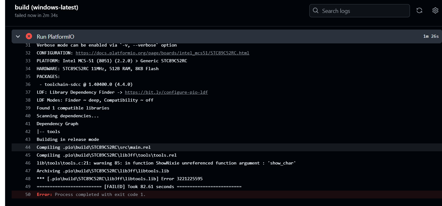

These are my code environments, and I don’t know where the error is, here is the error message below
The number 3221225781 is 0xc0000135 which is the error code for STATUS_DLL_NOT_FOUND. This usually means that a DLL that an EXE needs is not found.
But this is weird. When it fails in the “Archiving” step, that’s done with sdar and sdranlib
sdar rc .pio\build\STC89C52RC\libf32\libtools.lib .pio\build\STC89C52RC\libf32\tools\tools.rel
sdranlib .pio\build\STC89C52RC\libf32\libtools.lib
And these executables don’t have any DLL dependencies exact for the regular Windows ones.
>dumpbin /dependents C:\Users\Max\.platformio\packages\toolchain-sdcc\bin\sdranlib.exe

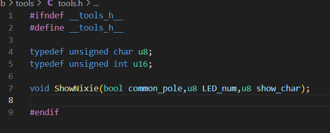

very simple a few files, because just started learning ![]()

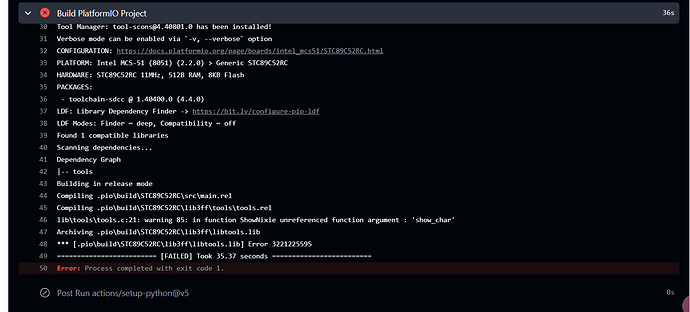

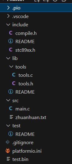

Sorry, since you created a non-standard folder structure with the PlatformIO project being actually inside the c51_project folder instead of the root, there is an additional cd c51_project needed. I have updated the text above, please update.

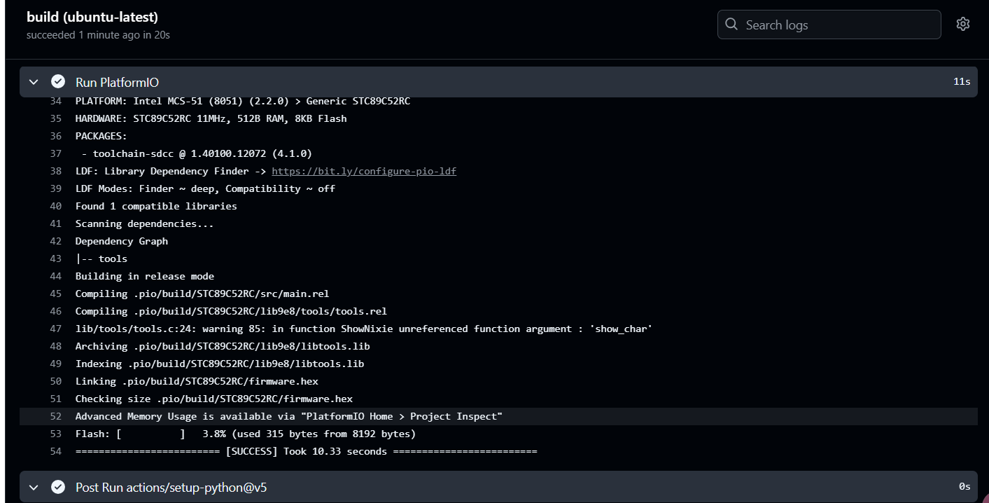

Can you use this build.yml file instead, it will try both Ubuntu (Linux) and Windows.

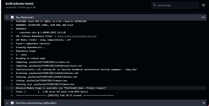

The ubuntu build succeeded, but the windows build still failed,Do I need to use a virtual environment to build my project now?
@maxgerhardt Are you there, very sorry to bother you, can this problem only be solved with a virtual environment?
Note that Ubuntu uses SDCC toolchain 4.1.0 while Windows uses 4.4.0

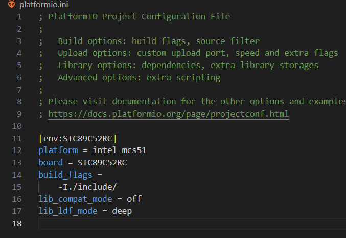

You can try adding into the platformio.ini:
; force toolchain 4.1.0
platform_packages =
toolchain-sdcc@~1.40100.0
and build again on Windows. (see available versions).
