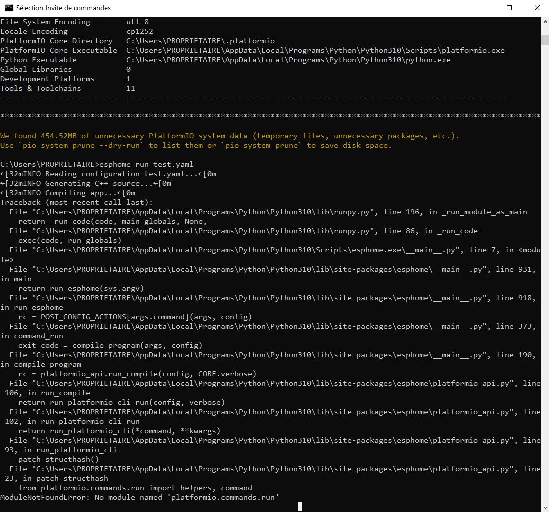

I typed : pip install -U platformio
and I got this message :
What should I try now ?
"Requirement already satifisied: 6.1.10 means you already have the 6.1.10 core.
You can type
pio system info
in the PlatformIO CLI to confirm this.

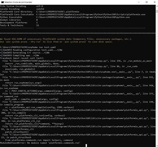

Now it is upgraded, but I have other message
The line from platformio.commands.run import helpers,command is not up-to-date anymore.
Please try and update esphome to the absolute latest:
pip uninstall esphome
pip install "https://github.com/esphome/esphome/archive/refs/heads/dev.zip"
SUPER it works now ; I just have compiled and flashed one of my ESP8266s :slight_smile:
