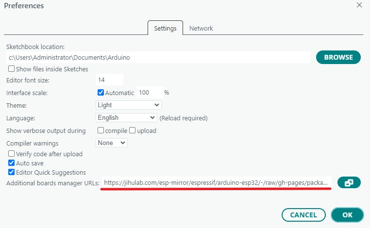

As the picture shows, it’s very slow.
I use a mirror link for arduino ide, it is fast for downloading:
https://jihulab.com/esp-mirror/espressif/arduino-esp32/-/raw/gh-pages/package_esp32_index_cn.json
It’s well known that the Arduino IDE isn’t as good as PlatformIO. I want to use PlatformIO in VS Code — is there any way to configure my platformio.ini (based on the parameters above) to speed up package downloads?
Best regards.
