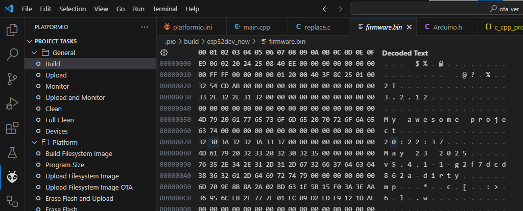

Mh, after some experimenting, it overwriting the app description block does work in Arduino-ESP32 3.x.
Just creating a new source file ver.c (it really has to be a .c file) and writing (similiar to this)
#include <assert.h>
#include <sys/param.h>
#include <string.h>
#include "esp_app_desc.h"
#include "sdkconfig.h"
#include "esp_log.h"
#if defined(__APPLE__) && CONFIG_IDF_TARGET_LINUX
const __attribute__((weak)) __attribute__((section("__RODATA_DESC,.rodata_desc")))  esp_app_desc_t esp_app_desc = {
#else
const __attribute__((weak)) __attribute__((section(".rodata_desc")))  esp_app_desc_t esp_app_desc = {
#endif
    ESP_APP_DESC_MAGIC_WORD,
    0,
    {0,0},
    "3.2.12",
     "My awesome project",
    __TIME__,
     __DATE__,
    IDF_VER
will make the resultant firmware.bin show those strings at the app description block (offset +0x10).

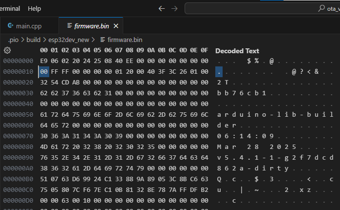

Without that file:
