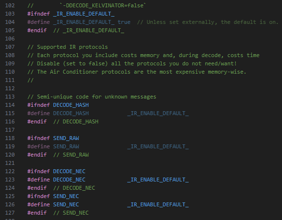

I will have a further look, but I think the logic in the library as downloaded is:
IRremoteESP8266.h
#ifndef _IR_ENABLE_DEFAULT_
#define _IR_ENABLE_DEFAULT_ true  // Unless set externally, the default is on.
#endif  // _IR_ENABLE_DEFAULT_
I define and set the value of IR_ENABLE_DEFAUL to false in the platform.ini
Then:
#ifndef DECODE_NEC
#define DECODE_NEC             _IR_ENABLE_DEFAULT_
#endif  // DECODE_NEC
#ifndef SEND_NEC
#define SEND_NEC               _IR_ENABLE_DEFAULT_
#endif  // SEND_NEC
So if I do not define SEND_NEC in platform.ini , then it will be defined in the IRremoteESP8266.h and have the value IR_ENAVLE_DEFAULT , which is now false
That was just a guess.

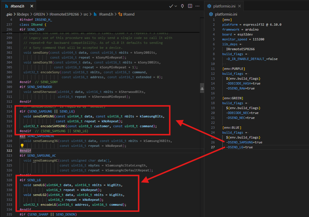

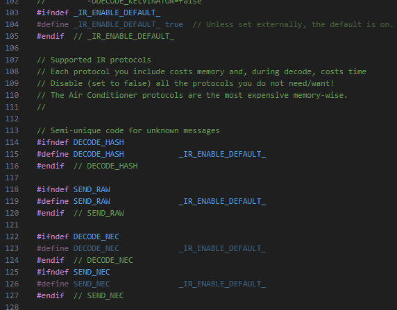

In the meantime, I took a look at the IRremoteESP8266 library to better understand the context. The following works for me:
[env]
platform = espressif32 @ 6.10.0
  IRremoteESP8266
  -D_IR_ENABLE_DEFAULT_=false
[env:PURPLE]
  ${env.build_flags}
  -DDECODE_HASH=true
  -DSEND_RAW=true
[env:GREEN]
  ${env.build_flags}
  -DDECODE_NEC=true
  -DSEND_NEC=true
Looking at the IRremoteESP8266.h with the different environments selected results in
PURPLE
DECODE_HASH and SEND_RAW expands to true
GREEN
DECODE_NEC and SEND_NEC exoabds to true

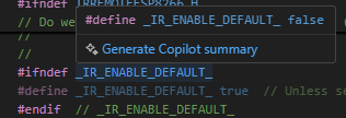

When hovering over _IR_ENABLE_DEFAULT_ in line 103 I can see that the macro expands to false:

(I don’t know how PlatformIO knows to show GREEN or PURPLE between compiles. Is it just showing the values evaluated in the last compile attempt?)

I see in your example that SEND_LG and SEND_SAMSUNG are active, but why didn’t it pick SEND_NEC (from GREEN) did you activate the BLUE environment before checking in the files?
I might put my code on github, or just make a quick and easy test with less clutter to see if I can reproduce your observations.
My code is rather cluttered. Making it succeptable for something not going like it is on your side, but also making it hard for anyone else to check whats going on.
Have to run home now, they are installing Airconditioning at home in an hour.
Thanks for all your effort.
The user (you) select the environment to be used in the “Project Environment Switcher” located in the bottom bar:
Because I had the BLUE environment selected in the projects environment switcher. So only the BLUE (and the general env) settings are applied.

When I checked my files yesterday, the macros did not behave as yours did.
But this bit of info is great, I will check it again.

If you didn’t choose a specific environment, the “default” will be used. So all settings which are available in the env setting will be applied.
Well then this info about the environment switch will make troubleshooting a bit easier. The more you know,!
