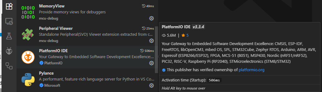

At the end I was able to install PIO in its latest version…

Interesting. So even VSCode 1.70.2 can have the latest PlatformIO VSCode extension version installed?
