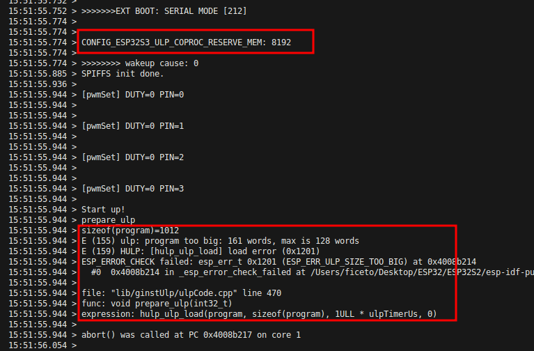

Using PlatformIO I’m getting an error ESP_ERR_ULP_SIZE_TOO_BIG even with increased value of CONFIG_ESP32_ULP_COPROC_RESERVE_MEM.
During power I see proper value of CONFIG_ESP32_ULP_COPROC_RESERVE_MEM but seems like it’s not being used for ULP init.
See screenshot below.
Thank you in advance.
