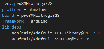

I added the Adafruit GFX and Adafruit SSD1306 Libraries.
I open the SSD1306 examples and copy that to src / main.cpp
When I compile the code I get errors.
Installed Libraries.
