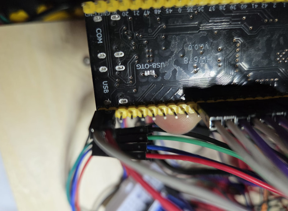

Thanks, my board is an esp32-s3-devkitc-1.
There are 2 usb c ports, one is called “COM” and the other one is called “USB”. I’m using “COM” to upload the firmware, which succeeds, I can see the led blink.
Now for debugging, I’d like to see the “Serial.print” as I did when using Arduino IDE. Thus I was trying the “upload and monitor” button.
This redirects it to the “USB” port not the “COM” port. Remove it.
Thanks a lot, it outputs “it blinks!”.
