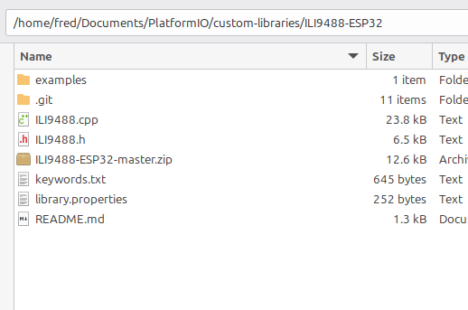

The only two versions that were successful was the use of the URL to the github library: https://github.com/dbyy/ILI9488-ESP32#master and the use of the custom library in the project folder structure itself (see attached screen shot)

I continued the testing using a custom library.
Nothing has changed on the locations from my previous post /home/fred/Documents/PlatformIO/custom-libraries/ILI9488-ESP32
