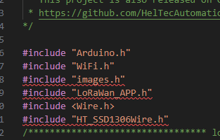

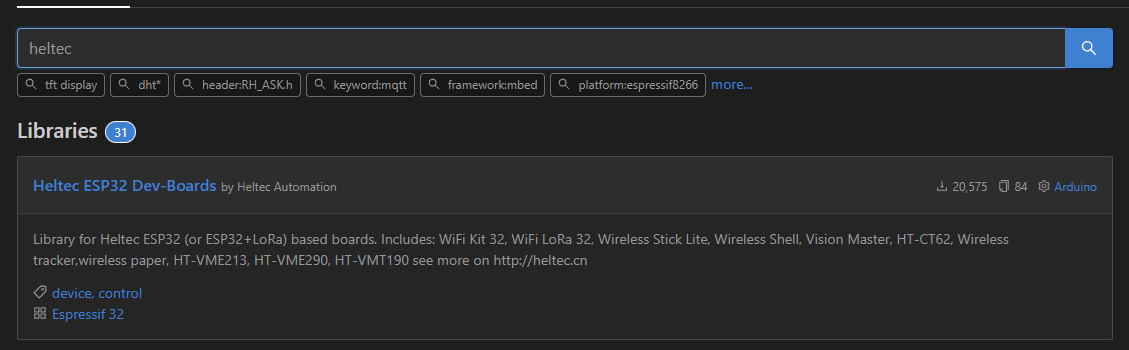

I have try to use
but I have this errors:
Thanks
None. The only known hacks are to copy parts of the Arduino core into the project and massage it to work. (Heltec lora boards with cli on macOS M1 - #2 by maxgerhardt). Noone has done the work to properly integrate the divergent Heltec core / Arduino-ESP32 fork into PlatformIO.
