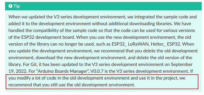

I developed a code some years ago with the old(official) heltec ESP32 LoRaWAN Library and it was working fine. As the company launched a new development environment the old library doesn’t work anymore. They advise on their documentation the following:
my question is how can i restrict platformIO to use the old environment? since every time i try to use the old code(even delete and copy the old library dip. folder), it seems that the code doesn’t work as it was.

This documentation does not apply at all. For board = heltec_wireless_stick_lite, PlatformIO uses the official Espressif-made Arduino-ESP32 v.2.0.9 (see variant), not Heltec’s forked core (v0.0.7). You can controll the version of the used Espressif Arduino-ESP32 core per documentation and releases. In standard PlatformIO, you cannot chose to use the Heltec core. There are forked platforms, however – unsupported officially.
