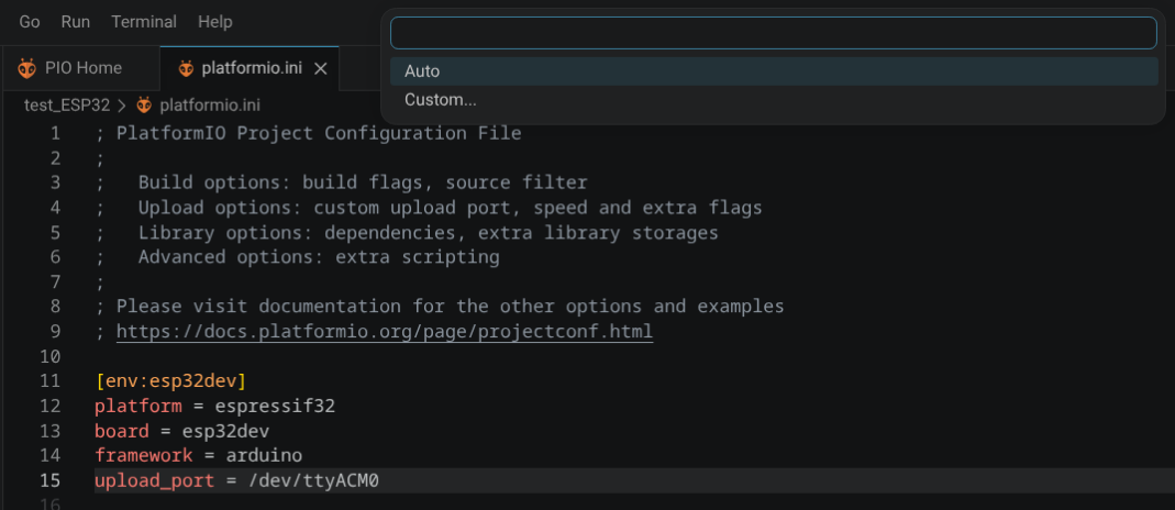

5. I configured the port in the new projects platformio.ini file to upload_port = /dev/ttyACM0.

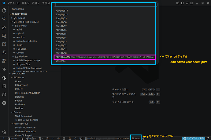

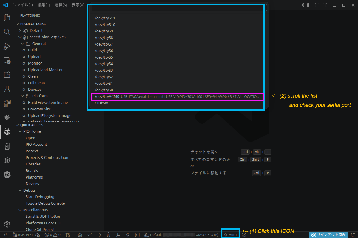

Have you actually connected a device via USB and checked which port is active?
I think it would be best to check this first, referring to the attached screenshot.
Scroll through the list of ports and find the same port you specified in platformio.ini:
Do you find it?
Unfortunately no, this is what I see currently.

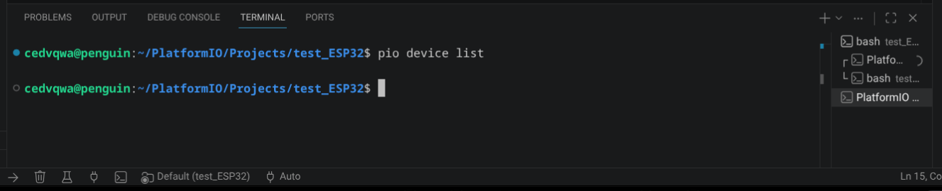

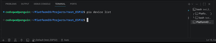

When I try to execute that command I get nothing.
Looks like missing drivers?

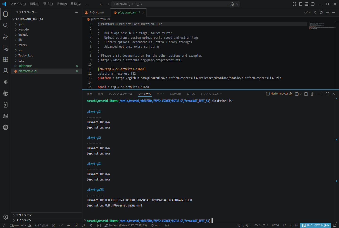

I think your terminal window is too small.
Please try enlarging it.(move the border)
You can it with your mouse,like this.
I think you’ll find the response for ‘pio device list’.

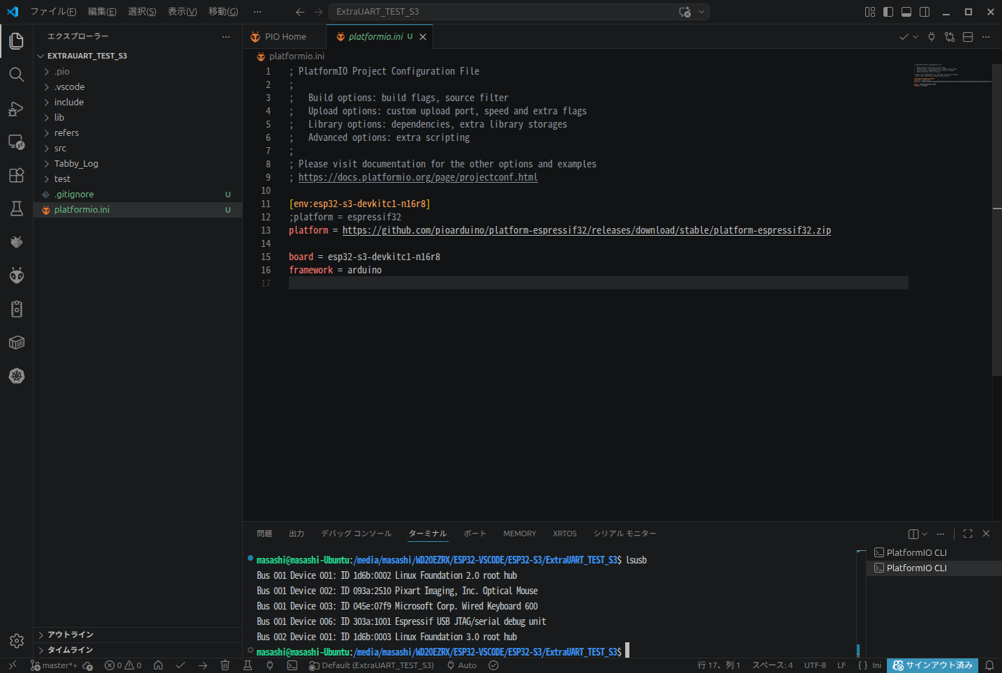

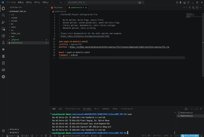

If you couldn’t find any response for ‘pio device list’ after enlarging window, how about the terminal command ‘lsusb’ ?
Can you see your mouse ,keyboard,etc. ?

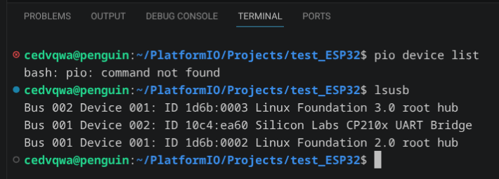

I made a separate post detailing my solution. But interestingly, I get “command not found” when entering pio device list. I also tried lsusb as suggested. Here is a screenshot of the results.
pio commands will work in a PlatformIO core CLI, but you can also also just add PlatformIO to your $PATH and it’ll work in any terminal.
