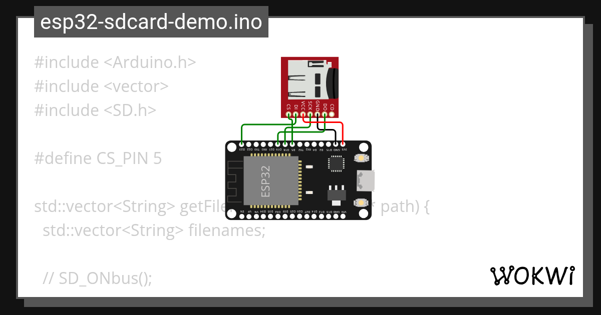

Take a look at
Things changed:
  • removed while (true)-loop
  • using std::vector as return type instead of using a fixed size global array
  • take the path parameter into account. The function can now be used for different paths on the SD-Card
