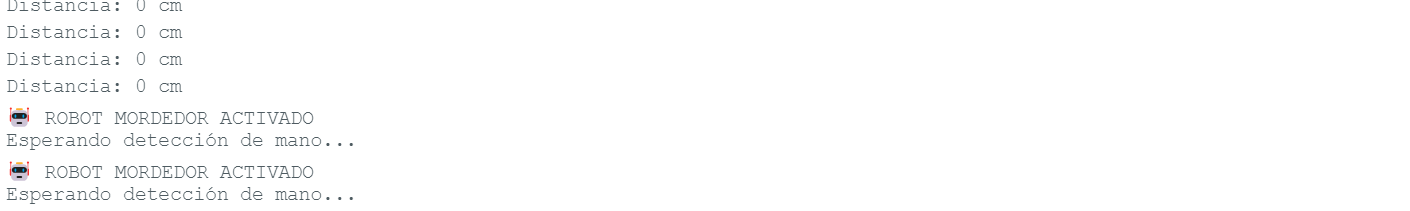

Hi, I was assigned two Arduino projects. The first one worked fine, but now that I need to do the second one, it’s not working. However, I’ve noticed that the first project is still functioning, meaning my Arduino still “thinks” I’m using the first one. PLEASE HELP!
Im also uploading what im seeing in my serial monitor

it is like my arduino it stuck in the old code because i literally try everything but nothing work
PLEASE HELP
So, are there any errors when you press the “Upload” button? Can you provide a screenshot of the IDE after you pressed the upload button, with the file explorer sidebar open?
Hello max thanks for responding my message there are any errors is like is working normally but with the old code, its like the old code is stucked in the arduino, I dont show any captures because its literally the new sketch and thats it
to resume no errors, only my old code
The above line in your `loop()` looks wrong. The ‘\’ character specifically.
This means your code did not compile, so there was nothing to upload, so the Arduino keeps running whatever was previously uploaded.
