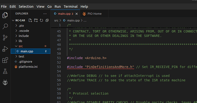

Header file can not be included
I am trying to upload the sktech from theIRremote library,however before I can upload it a problem emerges saying that :#include errors detected. Please update your includePath. Squiggles are disabled for this translation unit (/home/mehdi/Documents/PlatformIO/Projects/RC-CAR/src/main.cpp). and the #include "PinDefinitionsAndMore.h" // Set IR_RECEIVE_PIN for different CPU's 53 line get highlighted in red ,also a message right below it saying cannot open source file "PinDefinitionsAndMore.h" .

and here is my desktop screen
This sketch requires the file “PinDefinitionsAndMore.h” present either in the src or include folder. Do you have this file present in one of those folders?
after checking the folders no it is not present in neither folder
however i Found it here:
Then you should copy it from the example folder to one of the named folders…
so I should copy the file and include it where exactly?

so you are saying that besides the main.cpp file that is already in the src directory I should add those two files,am I correct?
right under th main.cpp?
Copy the PinDefinitionsAndMore.h file right beside your main.cpp into the src folder.
The TinyReceiver.cpp from my example is your main.cpp
